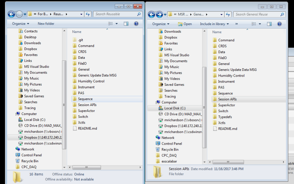

OK...so I am having a similar situation to this post.  I am trying to build a package while preserving the directory heiarchy.  The folder that I am trying to build looks like this:
On the left is the source directory.  On the right is the deployed directory.  If you notice, there is an extra folder in the deployed directory called Typedefs; this should not be there.  This folder actually resides in one of the other folders.
If I look in the vipm build spec (file called spec), I find this line:
File 71="vi.lib/MSR Consulting, LLC/General Reuse/Typedefs/Session Handle.ctl"
Does anyone have any thoughts as to why this is showing up in the build spec like this?  That folder needs to be in the place I specify, not pushed into another directory.

Never mind.... it  appears that the value Use Destination of Parent Folder under Source File Settings somehow got unchecked.  Carry on.
