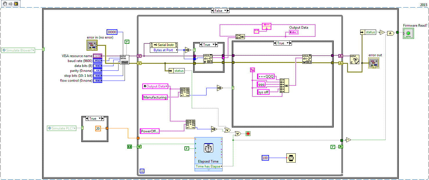

I'm trying to read the data out of a customer's proprietary hardware.  The output should look like the UUTOutput.txt file attached.  Unfortunately, the VISA Read routine is failing as soon as data starts to arrive at the COM9 port.  I'm using a TTL-232R-3V3 cable plugged into a USB port of the computer and can read and write data to the unit using PuTTY, so the communications are clean to and from the device, which means that I'm doing something critically wrong inside my LabView code (attached).
The data should start sending as soon as the power button is pressed on the unit.  Unfortunately, as soon as the power button is pressed, the VISA Read errors out.  I can sometines get the data to queue up and then read some of it, but it was failing out after the first line (figured out it was the termination character).  Now I cannot even get there.  However, I can always shut down LabView, open up PuTTY, and communicate clearly.

For those without 2015 see the snippet:Phase1-4 VI Snippet.png

The error (as displayed) is in the FrontPanel image on the right.  It is -1073807298 -- VISA Read in Phase1.4-Read Firmware Version.vi.

Are you sure the termination character should be disabled?  Looking at the text file, it looks like there is an End Of Line at the end of each message.
And continuing down that thought process, if you are using a termination character, then you should not be using the Bytes At Port to determine how many bytes to read.  You should tell the VISA Read to read more than the longest message you expect to ever recieve.  The VISA Read will stop reading when it finds the termination character or when the desired number of bytes come in, whichever is first.
This just makes sure you get a full message each time you do a read.  You can then do your checks for reactions to the data based on the current message instead of the entire amount of data that has come in.

Get into the habit where you use the error wire to wire EVERYTHING through it. Just something that I have gottem anal about becasuse I've been burned too many times by that.
Wire your error wires through the Bytes at Port and put a small flat sequence structure with about a 500msec wait inside that and wire your VISA wire and error cluster wire through it if your term. char. is False. Kinda like this:
