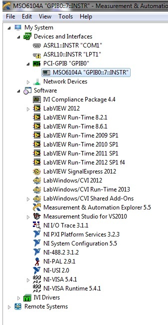

Hi, I am having the same problem. I recenlty purchased another computer and put LV 2012 on it and then copied by LV code from another computer running 2010. Now none of my GPIB or VISA functions will work. Can you help? Any ideas? I am able to connect to the GPIB device within MAX but not within my LV code. Here is a screen shot of MAX which may help.
