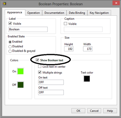

Hi Remko,
Probably I Understood your problem. Its simple to do. Just make a right click over LED control --> Properties and make a check on a "Show boolean text". You can enter the text want you want to display during ON and OFF of your LED control. Now run the VI. It will not disturb you while press over the LED. Refer the below picture.
Actually I dint see the above replies and I simply posted my thought. The solution were given already.
