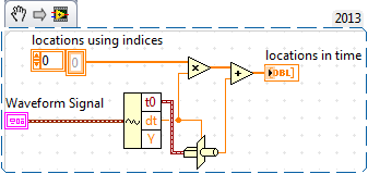

Here si my proposal:
If you have other Signal type, describe it or post it.

I am using a simulated sine waveform as my input, i am able to find the locations (value is 2.5) of this waveform using the peak detector. I am jus curious to know what this signifies and can this data be used for any feature extraction? Since i am working on Diagnosis of Few machine components.

The peak detector does just that - it detects peaks. A peak is defined as a place in the data set where the signal rises to a (local) maximum and then falls again. The width parameter specifies the minimum number of samples in a peak.  It is slightly more complicated than that simple definition because it fits a polynomial to groups of data points containing ~width samples. So noise which can cause the signal to jump around is smoothed by the fitting process. The "location" of the peak is calculated from the coefficients of the polynomial and may not exactly match the array index of the input data.
The peak detector can be used to find peaks which meet this definition. To find other kinds of features you will need to use other functions.
