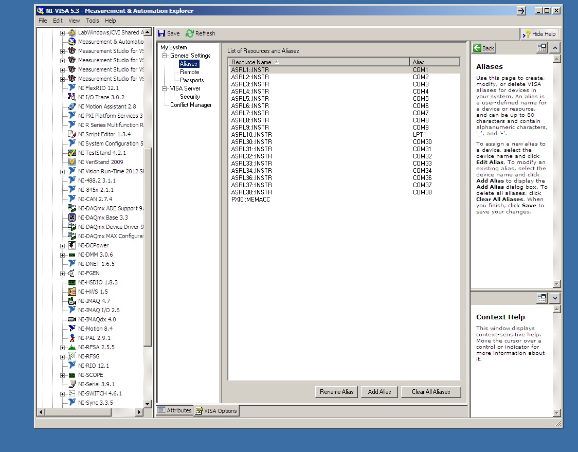

I believe you have found the problem, Jeff!  Here's a snapshot of my list of resources/aliases under MAX:
Originally the list only included the info for COM ports 1 through 4, and then 30 through 38.  The only time my program worked was whenever the VCP chose COM4 as the port.  So I added the info for COM ports 5 through 9 and tried again.  This time the VCP chose COM port 7, and my program worked fine!
But now here is my question - is there a way that I can have LV automatically see the ports and add them to the list so I don't have to actually type in every possible com port into this list?

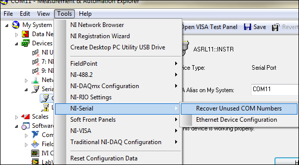

Another thing to try is to recover the unused COM Port numbers each time you change the device.  By default Windows will "Save" those previously connected COM port numbers an if it sees the device again it will re-assign the old number.  This means that the COM number keeps getting larger and larger.  At some point the PC's BIOS will say that's rediculous and you will experience trouble.
Programatically you could call
C:\Program Files\National Instruments\NI-Serial\NiPortConfig.exe to launch the same utility.  there is probably even and unpublished switch to click just that one big button for you but I can't find it.
