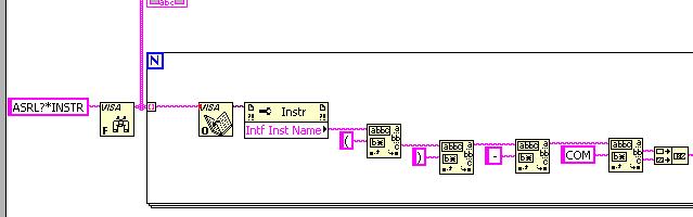

Anyways, I am planning to implement the following code:
Just wanted to confirm if something of this sort is possible with VISA resource name settings?Smiley Wink
