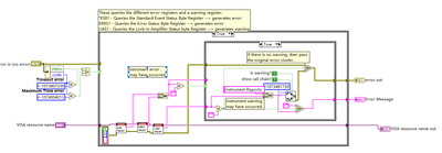

there is a subVI that is not able to pass the serial port address to next subVI.
This is the subVI called "Error Query.vi"
This is the internal structure.

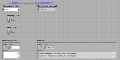

More weird thing happened. If I open the "Highlight Execution" of this subVI, the serial port can be correctly passed.
This would be like
You can see the address is sucessfully passed. Otherwise(the Highlight Execution is not turned on), the address cannot be passed,
Be like
You can see that the "VISA resource name out" is empty, this means the address didn't pass through.

At the end of the "Initialize" VI there is this:
That is the only place I can find that could possibly be clearing the VISA address and it should only happen on an error, not on a warning.  Are you sure it wasn't running in such a way that it got an error in the Initialize VI that could have cleared it?

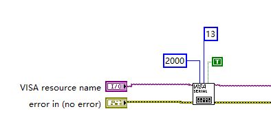

After the post for help, I tried to seek the reason of the bug myself.
As whether the bulk is turned on is a factor of influence, I thought maybe the serial port timeout is wrongly set.
This can be the case: Without the bulk turned on, the program is run in a fast way. The program hasn't had a chance to receive the message, and VISA read has already timed out.
But with the bulk turned on, every step is run in a very slow way. The VISA read is able to receive the message before timeout.
So I reset the Serial Port Timeout from 1000ms to 2000ms.
And this magically worked out.
