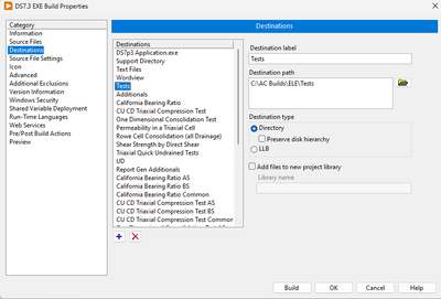

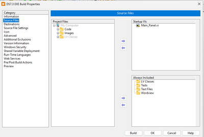

When I build exe two folder (With name-Tests and Texts File)  is coming missing , I have select these folder into always include but it is not coming after completing build file or in preview file also.

Do you wanted to add this files in Data folder or in some designated Folder like "C/Project/Config"?

LabVIEW Application Builder does not copy empty folders to the destination. They must contain at least 1 file.
Alternatively, you could create a post-build action that automatically creates the folders if they don't exist in the destination folder.

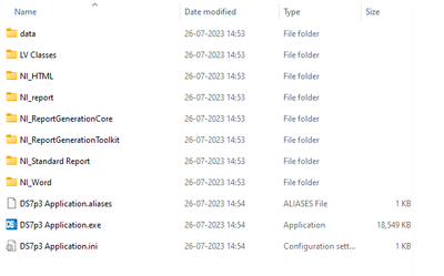

Folder should come separate like data folder LV Classes these two folder should also come in same path.

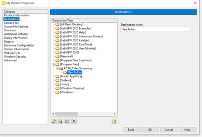

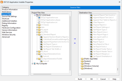

Explore Destinations in the Installer Properties
Palanivel Thiruvenkadam | பழனிவேல் திருவெங்கடம்

but I need this folder in build file also, is there any possiblity.

what do you mean by build file? Exe?
If you create an installer and when you install all your required folders/files will be created/Copied in the respective file path.

@Poojaavi123
Have you read my comment ?

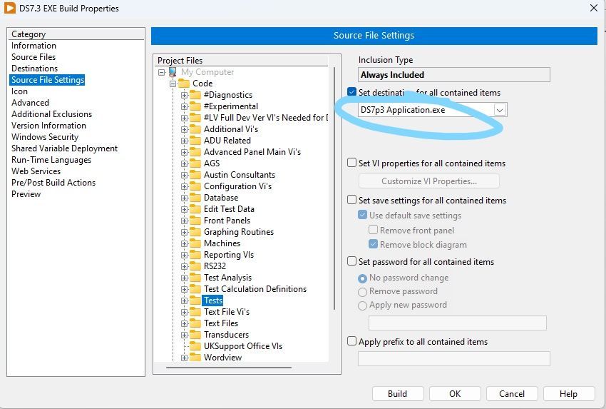

It does not work if your original folders are empty.
Also, you must create dedicated destination folders (in the "Destination" tab) and set the destination for the items contained in the folders (in the "Source File Settings" tab).

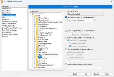

Yes I have read your comment  original folders are not empty.
and I have created destination folders (in the "Destination" tab) and set the destination for the items .
But this folder is still missing in exe and installer

Your folder is inside the executable.
