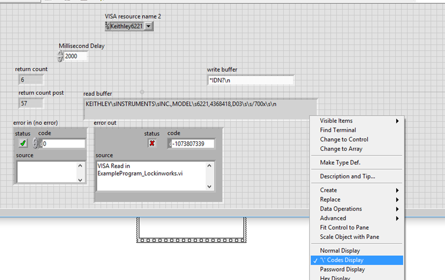

I changed the display mode and the code is now "*IDN?\n" but I still have the timeout error. However, for the first time it is sending back some response. I've attached a picture of the response I got. I'm not sure why the return count would be 57, but its an improvement from 0.

You should show enlarge the string indicator so we can see the entire message.  Perhaps put it in \code mode so  we can see any of the non-printable characters.  The return count is 57 bytes because that is how many characters there are in the message.  Seeing the entire string will help figure out if that makes sense.

Message 9 of 11
(3,886 Views)
That looks good other than the timeout error.  I wonder if that port is not set up to use the linefeed character for the termination character.  I don't know if ethernet ports behave differently, but the vast majority of my experience is with serial ports.
