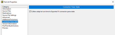

Actually, "NI technical support" found a part of the solution : in the properties of the build of the Packaged lib you have to uncheck "Callers adapt at runtime to Exported VI connector pane state" and rebuild the lib
But this is not enough : if you just run again the caller VI (main project) it's still running slowly . "NI technical support" suggested to replace manually in the caller VIs all the calls to the VIs of the lib (and it works), but this is impossible to do in a project of several thousand VIs.
I tried a "mass compile" but it didn't work (?!). At the end, what works is "Ctrl+Shift+Run" (force recompile) with all VIs of the main project loaded in memory (opening the main VI and opening directly other VIs if dynamically loaded).
At the end, what I don't really understand is the relation between this option and the execution time, because even if you leave this option checked, and you change the connector panel of a VI in the lib, you still have to reload and recompile the caller VIs in the main project, so it seams to me that callers VIs never adapt to connector panel change. So at the end, to me it would be better to uncheck this option by default...
