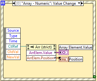

Position is indeed element-dependent. And you can get to it relatively easily from the Array >> Value Change event:
I guess that, assuming that a single element was modified at a time, which sounds reasonable, finding the index of the modified element would be easier by comparing old and new array value.

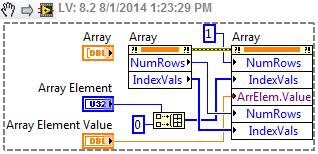

@X. wrote:
@crossrulz wrote:
 You can set the active element with a property of the array (having trouble finding it at the moment).
Show me that and you'll get a kudo.
Not even close, but it works.
Jim
Message 13 of 14
(1,311 Views)
@jcarmody: I am not sure this qualifies as a solution...
Your approach has the top left element sometimes fleetingly show a changing value (as it moves the intended element to be modified in this location instead of the one that was sitting there).
Moreover, if I add a Arr.Elem.Value at the bottom of the PN stack, I don't get the element that was just modified but the original (and still identical) top left value.
