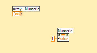

Drop an array of numerics on the FP. Show a few elements. The easiest is to grab an "Array - Numeric (Silver)" preformed object, with 3 elements shown.
Now, right-click on the top element and select: Create>>Property Node>>Value
Change that to write on the BD and connect a constant to it, say 1. Run the VI, you get this:

Now do the same for the THIRD element and wire a different constant to the PN, say 3. Run the VI again, you get this:

Now, delete the first PN and rerun the VI:
Screen Shot 2014-07-30 at 15.14.40.png===>Screen Shot 2014-07-30 at 15.14.49.png

You are creating a shortcut to write to the ArrElem.Value property.  The ArrayElement property of an array is a bit funky, it is the last element which has been active.  With only a single PN on your BD writing a value, click in the middle element of the array and then run the VI, repeat for other elements.
Message 2 of 14
(7,837 Views)
In the second picture, you didn't enforce the data flow, so the 3rd item in the array (the active one) got set to 3, and then set to 1.
If you enforce the data flow, it looks different.
You will get 3 instead of 1, if you wire like this:

As Darrin said, it just matters which element is considered the "active" element.  So in your second example, you actually wrote to it a 3 and then a 1 (classic race condition).  You can set the active element with a property of the array (having trouble finding it at the moment).
