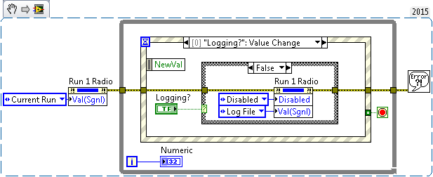

@gintree78 wrote:
That being said, Bob I agree that this is probably unnecessarily complex.  I'll play around with making an event case for each event.
I'll say it's overly complex.  Take a look at the enclosed (this is a LabVIEW Snippet -- open a blank LabVIEW 2015 Block Diagram and drag this image into it -- it will automagically become LabVIEW Code).  I simplified disabling the Radio Button Control (I disable the entire control, much simpler).  Why do you think I put the extra Value Signalling property node outside the While loop?  And what's with that error line, anyway?  [Did you see the word "Display" in your Display indicator?  Extra points for figuring out how to see it ...].
Bob Schor
Message 7 of 10
(6,732 Views)
Oops.  There's a subtle logic flaw in my demo -- a prize to the Original Poster when he (or she) finds it.
BS
Message 8 of 10
BS
Oh, oh, oh! *waves hand* could it have to do with ordering? Btw i've had issues with using the control in the event structure like that a couple of times, and had to use the NewVal instead.
/Y
No fair!  You were not the Original Poster!
I also almost always use New Value, but wanted to keep it as basic as possible to focus on (what I see as) the "best use" of the Event Structure.  In my experience, having an Event case handle one Event and do one thing (more and more, that "thing" is to send a message to a Message Handler/State Machine loop) leads to cleaner, leaner, and "more likely to (a) be correct and (b) do what I want it to do" code.
