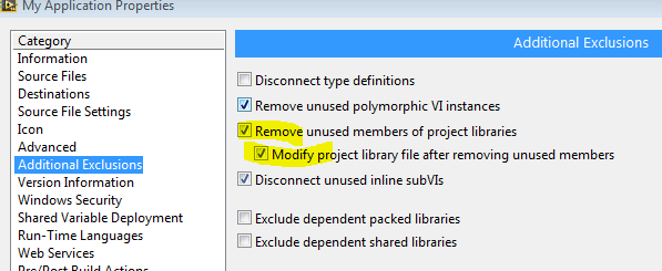

I can't open a 2015 file yet but, perhaps I can shed some light.
Check the build spec here
Sicne it seam like you are spawning by name the vis appear unused and the built library will not contain those vi's by default.  unchecking those options should help

The VIs aren't actually called by name, they are called with a static VI reference on the block diagram of the main VI. Changing the exclusion settings did "fix" the problem if I unchecked Remove unused members of project libraries, but that forced an inclusion of vilib and the executable blew up from 250kB to 5.5MB.
That actually makes a bit of sense.  you call a vi in a lvlib dynamicallyyou need to add it to the build spec somehow.  a lvlib is a single file so, the entire lvlib needs to be loaded to have the vi in the build.  depending on how large the library is you can get a lot of bloat in the exe.
Most libraries are not 5.25MB (if yours is you may want to consider restructuringSmiley Wink)  Changing the exclusion settings would apply to all lvlibs.  Try adding the specific lvlib to the allways encluded source file list instead
