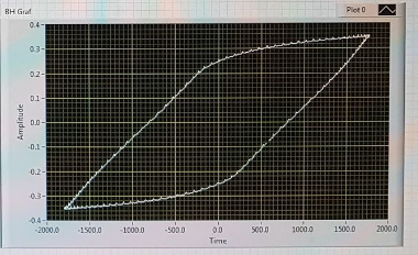

Hi, I am stuck with a problem. I need to find out the values on the axes, when for example y=0 and x is a value, oe the second option when value on axis y is a value not equal to zero and x=0. It is a hysteresis loop and a need values of Hc and Br.

Do you have data array? Can you show example?

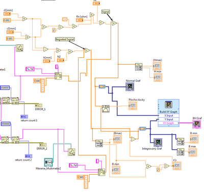

Are you looking for an exact value for one of the axes, or can it be between array elements?
If exact , then use the "array search" to find the index in the first array. Then take the element in the second array with this index. Do it twice.
