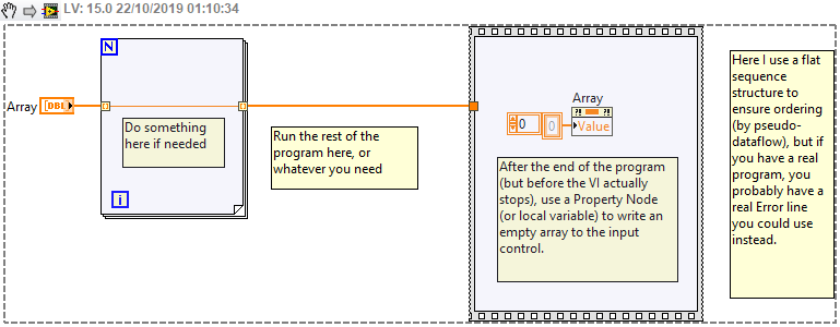

I'm a little confused by (and perhaps others are too) how you want this program to be used.
You have an Array control on the front panel. Each time you run this program, you want the user to set some specific data values. You want to be able to remove old data, by the sounds of it.
Do you need to retain any of the input data (after the previous run)?
If not,you could try something like the following:
Note this is more or less solving your problem with a sledgehammer, and will be frustrating if you want to enter the same values over and over... but without more information it's the first that comes to mind.
If you give a bit more detail about the desired workflow etc, it might be possible to suggest a better method.
