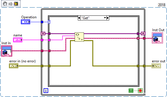

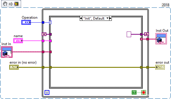

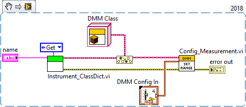

So I tried this and it works, but wondering if there is a more elegant way of doing what I am doing now...  I ended having to call a "To More Specific Class" function to down cast my "Instrument" dictionary.  My current dictionary is as follows:

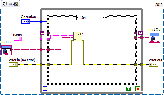

InitInitGetGetSetSet

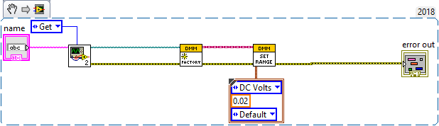

This is straight forward with the 3 inherited methods: "Initialize", "Reset", and "Close" but for "Instrument Type" specific methods it would cause me to down cast in every wrapper.  Is there a way to avoid this or this is what I am stuck with?
DMM_SetRange Test WrapperDMM_SetRange Test Wrapper
Here is your trade-off:
1. Have a central dictionary and have to use To More Specific Class in all of your wrapppers
OR
2. Have a different dictionary for each instrument, also causing you to have to duplicate Initialize, Reset, and Close methods
OR
3. Way overload your Instrument class with every single possible method any instrument could possibly use so that "Set Voltage" is in the instrument class
I chose #2.  This is where traits would come in handy.

Hi cross,

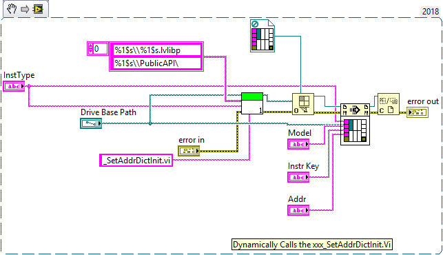

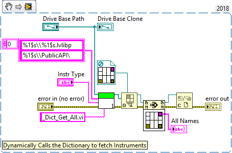

May I know how you are calling these lookup dictionaries?  I have 4 public access wrappers: Init, Set, Get, Get all for all my instrument dictionaries.

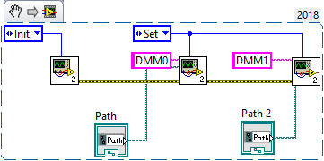

I was experimenting with them in phases.  I originally had a top level VI that was initializing all the dictionaries and setting my instrument classes into them.  This was done by reading an ini file and see what was configured in the system then my top level VI was calling the dictionary initialization using a case structure.
Now, I am trying to move away from using the case statement and started to use call by reference to dynamically load up the dictionary.  However, I run into the issue that when I tried to access the dictionary later, they are all empty.  I suspect that they are not being kept in memory, so when I reference them later, there are no valid data (key or class values) kept inside.
I am actually using one of your snippets as a path finder to help load and it works very well so I don't think it is a pathing problem.
