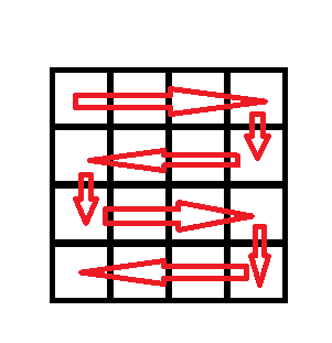

Hello VGans,
You should keep in mind the ratio between the drill size and the pixels per carvable cm (or per mm).
Once you know how these relaten, then you can define how you should handle each pixel (that can relate to a block).
For the pixel per pixel example this could the become something like this:
- Imagine you have a 100x100 cm (Carve area = 10000 cm²) carving surface and your drill has a 1 cm diameter (diameter).
- Imagine you have an image that has 25x25 (Image points=625) pixels.
- In this case ("Carve Area"/"diameter^2") / "Image Points" gives you the value 16.
This means that you will have to carve 16 physical points for each pixel point.
Please  note that this definition is far from perfect, since it also ignores the fact that the drill will give you rounded corners.
However, I would not dare to call this a "good solution".

Hi Thierry,
Thanks for all your help! 🙂
We have developped a vi that uses the solution you propose. (line per line). Indeed, it is not the best solution, and it is quite slower than when we just draw something on labview, but given the fact that the maximum carving surface is quite small, it is not such a big deal.
We've manage to vectorize the image and it works fine. we only have small issues with the colors, but we were thinking of working with levels of grey so that there are less different colors.
