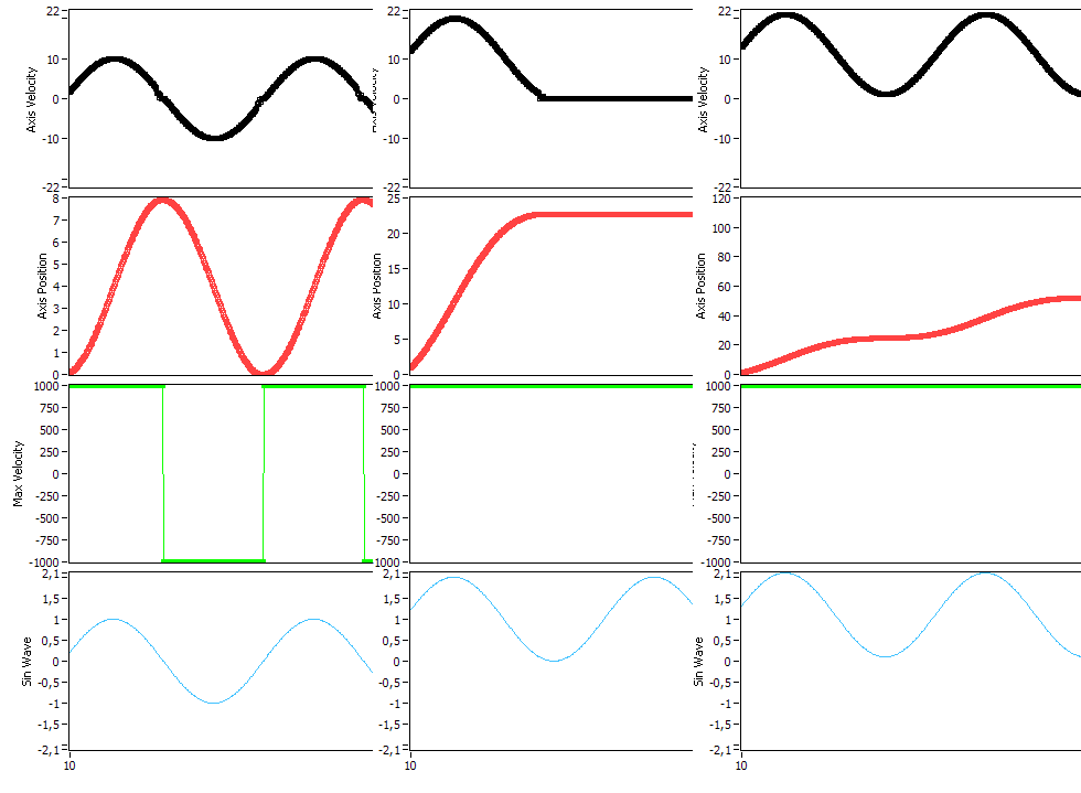

The test routine runs circa correctly until the velocity profile cross the zero, at that time the routine stops with the following Error -77070.
I have added an offset to the generated sinusoidal profile. The test routine runs correctly if the offset sets the sinusoidal profile all positive or all negative, i.e. the offset is greater than sinusoidal amplitude.
Question (1)
I beleave that this behavior is due to a bug in the Straigth-Line Move node. I am right?

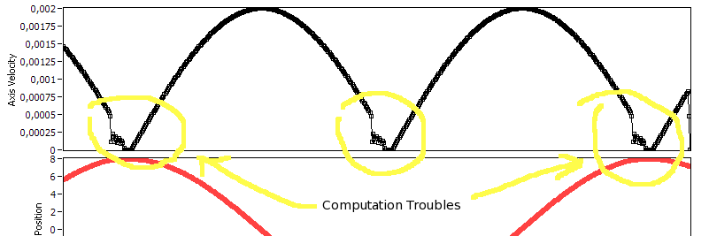

The velocity plot shows some computation troubles as the derivative is negative and the velocity is approaching the zero. The intensity of the computation troubles depends from settings and the computation troubles show a strong repeatability.
This computation troubles are present when the velocity is updated both with "Velocity Override" Write and with "velocity" Straigth-Line Move.
From where this computation troubles comes out?

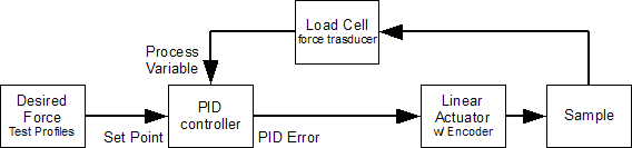

In my system I need to close the loop in force (measured by a load cell) and to move a stepper motor following a velocity profile. The velocity profile is the PID output (error).
To reach a good stability of the system, the control loop should iterate every few milliseconds or faster.
For instance, when the system is in control the PID error will be oft near to zero, by moving between negative and positive numbers. The velocity zero is very important in close loop control!

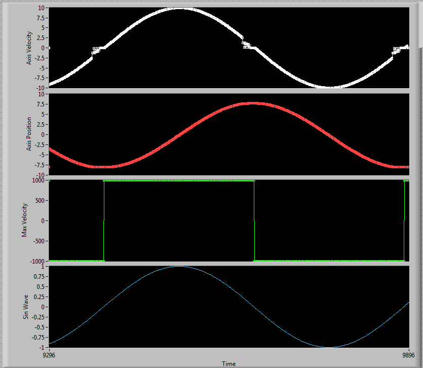

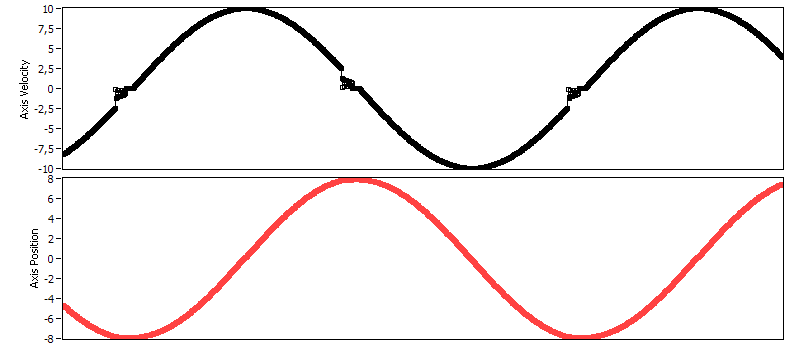

I ran the code  Axis Override Test 1 on my machine on a simulated Axis and this was the performance I observed:

Question (1)
Why the velocity that is read from the Read (Data) function block is positive also in case of negative move?
 Our versions maybe differing did you see the same behavior on a simulated axis?
Question (2)

Hi Reid,

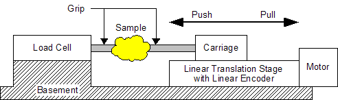

I am developing a system for low-force tests of very thin tissues in tension and fatigue.
The force is measured with a load cell and is applied by pulling the sample with a linear translation stage and the elongation is measured with a linear encoder.
The linear stage is motorized with a 2-phase-stepper motor, and with two limit switches. The stepper is designed for applications with very limited space conditions and the motor is hollow.
The linear encoder has a 20 nm resolution and a 1 um accuracy, and includes an electronic for signal conditioning that is compliant with the encoder input of the NI 9512 module.
The load cell is a full bridge with an accuracy better than 0.01 %. For acquiring and conditioning the full bridge, the system uses a NI 9237.
The system will provide tests that are controlled both in force and in elongation.
For the tests controlled in force, the loop is closed with the signal measured by the load cell and the translation stage is driven in velocity.
For the tests controlled in elongation, the loop is closed with the encoder signal and the translation stage is driven in position.
For both type of tests, the user can select different test profiles, for example: a linear increasing, a sinusoidal profile for fatigue test, etc.
The user can pause the test at any time, and the system must take the condition, until the next proceed command.
My previous post: question (1)
Your reply:
Concerning the velocity that is read from the Read (Data) function block, I observe the following:
With a simulated axis (both in My computer and in cRIO-9073) the values are positive for forward move and they are negative for backward move (as you also have observed).
With the real axis (NI 9512) the values are positive both for forward move and backward move.
Please see the next images.
With simulated axis
 With real axis (NI 9512)

My previous post: question (2)
Your reply:
These two questions I feel share the same root cause. It takes a little bit longer to calculate the a preemptive move in the opposite direction.
Considering the observation on the Read (Data) function block issue, now I note that my second question arises from the sum of two different behaviors. In case the Read (Data) function block issue is solved, as for simulated axis, the sentence can be rewritten as:

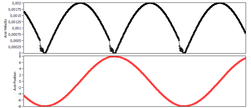

The velocity plot shows some computation troubles as the velocity is approaching the zero, with the derivative both positive and negative.
Furthermore I have discovered that this computation troubles gives a blocking error if the velocity is approaching the zero with a zero derivative.
Once the velocity reaches the zero with a zero derivative, the "Velocity Override" Write is no any more able to change the velocity!
No errors or warnings comes out in this situation!
This behavior is true with an axis both real and simulated, and is still true both with an all function blocks code and a mixed function blocks/invoke nodes code.
From this point of view, the velocity troubles with the approaching to zero are very very bad!
Please consider that in the previous posted example you can find an all function blocks code, Axis Velocity Override_test_0.vi, and a mixed function blocks/invoke nodes code,  Axis Velocity Override_test_1.vi.
You can easily test the velocity blocking error by putting the parameter offset = amplitude in the previous posted example.

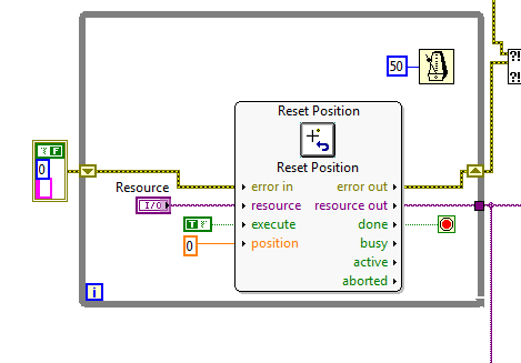

Make the following change:

please find in the next figure a sketch of a side view of the system for low-force tests.
The load cell measures the force applied to the sample and the linear encoder measures the elongation of the sample (once the correction for the load cell deformation is applied).
The motor moves the carriage trough a lead screw (ball screw).
The carriage position determines the sample elongation and consequently the force applied. Until the sample is in the elastic phase there is a proportionality between elongation and force applied, beyond, in the inelastic phase as the elongation increases the force applied don't change any more or it follows an unpredictable law. As the sample starts to break, the force decreases as the elongation increases.
For the test controlled in force, for example, a linear increasing test profile will correspond, in the elastic phase, to an elongation to constant speed. As the inelastic phase starts, the elongation will speed up to try to increase the force. Quickly the sample will break, the force will decrease abruptly and the control will stop the test.
My idea on the force control loop is illustrated on the next figure, where the PID error controls the movement of the stepper.
For the other case of force control, in each scan loop would you be taking a reading of force as an analog voltage and then setting velocity off of this?
Yes, this was my plane.
Done, thank.
As for the Velocity not changing after small changes are made, I saw the same performance on the issue with making small changes to the Velocity around zero. I didn’t see it in this code, but I have seen trajectory generator stop generating new points when repeatedly called with small changes in velocity. I wasn’t aware that the derivative had an effect, I think more what we are seeing is that the new straight-line velocity is not being loaded so velocity override has nothing to really update.
To further investigate the behavior around zero, I have tested different settings for the Offset parameter of the posted example.
In the next figure I have superimposed three plots that have been obtained with different settings for the Offset parameter and a simulated axis:
a) the more left plot is obtained with Offset = 0.
    The velocity plot shows some computation troubles as the velocity is approaching the zero.
b) the central plot is obtained with Offset = Amplitude = 1.
    The velocity plot shows that as the velocity reaches the zero, the "Velocity Override" Write is no any more able to change the velocity.
c) the more right plot is obtained with Offset just bigger than Amplitude (Offset = 1.01 > Amplitude = 1.00);
    The velocity plot shows the expected behavior.
With the SoftMotion example Axis Velocity Override.lvproj it is possible to use the Velocity Override function block for manually set different velocities.
(C:\Program Files\National Instruments\LabVIEW 2009\examples\motion\FunctionBlocks\Axis Velocity Override)
For example, the Velocity Override works correctly, starting from 100%, to set 0% and to set again back 100%.
If you try, starting from 100%, to set a small value, let say 0.1%,  the Velocity Override is not any more able to set back a value different from zero!
I agree with you, the derivative of the velocity has no effect with the behavior associated with b) and with the manual Velocity Override.
The manual Velocity Override shows that the previous behavior is not associated with "making small changes to the Velocity around zero" but it simply associated with the Velocity that assumes values around zero.
Is important to note that a jump of the velocity between a big value and 0, makes no troubles.
I have note that setting a new velocity value with the "velocity" Straigth-Line Move erases the previous unsuspected issue and the Velocity Override is again able to set back a value different from zero!
I'm not sure that the case a) and b) are associated to the same issue.
The case a) incorporates the case b) but, as the zero is crossed, the "velocity" Straigth-Line Move, implemented in the work around routine, enables the Velocity Override to set again a value different from zero.
The case a) shows velocity computation troubles as the velocity is approaching the zero. Furthermore the case a) shows that the velocity computation is correct as the velocity is leaving the zero.
I'm surprise to observe that computation troubles as the velocity is approaching the zero are present only if the velocity crosses the zero, otherwise, see case c), the velocity computation is correct.
The velocity threshold for issue a) and b) seems to be differents, the velocity threshold appears higher for issue a) than b).

Hi Asper
I understand your concerns, I agree that we should look into figuring out a successful solution versus taking basically with our current system I imagine all the coding for the positioning went fine but we are running into difficulties implementing the analog feedback. The real problem is with a stepper motor we don't control the current to the coils directly, I have seen some new technology on drives that will start to allow stepper motors to begin to move into this field. It's the current running through the motor that relates to the torque it outputs. I know you are already familiar with the basic concepts of stepper control, but so others reading this forum can follow along I'm going to go from the basics, right now we send a step and direction which corresponds to a position. Even if there was a way to directly add the analog feedback to our stepper it wouldn't provide a difference in force, I also think running the control loop in RT could potentially damage the sample, if our loop finishes late and our setpoint on the FPGA is not updated it could get damaged by the stage.
Ideal Solution to Application:
We need to use a control loop like this for torque control. The commanded positions for force would be given in RT and the PID would be performed in FPGA. With our 9505 module you could directly drive a servo motor changing the current and updating the correct value in a PID on FPGA, thus with the current control we can then control torque. The analog feedback would be wired into the 9237 module. The 9505 would also feature the encoder inputs you would need for doing position control. The current motors are stepper and the 9505 would need to be used with a servo motor.
With Current System:
With the current system because we are using a stepper motor that runs at a constant torque we won't be able to directly use the load cell in our feedback. Is the goal is to be able to read in from our load cell and command our motor until a set stress strain is achieved? This I thinkshould be possible by making small commanded moves in RT and then reading back the settled strain and moving to another position based off this. What we would be doing is commanding force by providing displacement that lead to pressure on the sample. Your code could then function in this manner and provide the user with the ability to directly set the displacement and read the force on the load cell from that. With the stepper you will not be able to turn the motor harder or softer on command so this will be your constraint.
