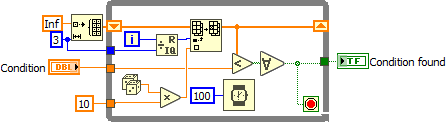

While Tim's code is simpler, my code is more flexible because I assumed that you'll ultimately receive data in the loop forever, one point at a time, then continue once the condition is met. Just change to a while loop and read your AI or whatever inside the loop.
Here's how that could look like. This loop will stop after three successive random numbers [0..10] are all <2.
Message 7 of 8
