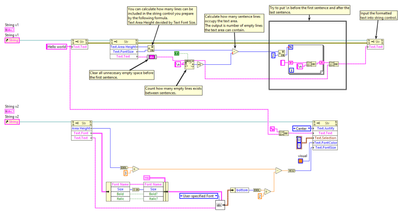

I'm looking for a property node that can perform the "Lock text in center" functionality. Using the property node called Justification I get horizontal alignment. In order to achieve vertical alignment (so that the text is somewhere in the middle of the string indicator) I need to perform certain actions.
The above code is an example I found online but it doesn't satisfy me. I'm interested in a more accurate way. So I tried (in the code below) to do something like this.
Finally I want to create a subVI that will perform this feature.

Here are some options I would test if I wanted to do this:
  1. Use a picture control instead of a string. There you should be able to set the alignment for both axes, but I'm guessing the text might appear aliased.
  2. Use a .NET control which has this (even the standard textbox might).
  3. Use one element for the background and a second transparent string indicator for the actual text. Calculate the vertical text size, and then resize (I see that the String class has a Size to Text method, but I didn't test it) and position the transparent indicator appropriately so that it's centered on the background element..
None of these are ideal, but I think that's where I would start.

Thank you for your response. I'm interested to hear what do you think about the solution I proposed in the code I sent? Add end of line to the text at the beginning of the sentence, and define its size according to the container and the height of the text.

"Lock Text in Center" is a property of boolean controls.
paul_a_cardinale_0-1730913307002.pngpaul_a_cardinale_0-1730913307002.png  It doesn't affect justification within the text, it affects the position of the text in the boolean.
There is no text property for vertical justification.
Consider using the paul_a_cardinale_1-1730913809134.pngpaul_a_cardinale_1-1730913809134.png method; then adjust the position accordingly paul_a_cardinale_2-1730913862411.pngpaul_a_cardinale_2-1730913862411.png.
  1. I don't like the idea of modifying things to get what you want (adding a new line, changing the font size).
  2. I don't know which math problems you ran into, but your code can also have other complications (such as text with mixed fonts, your use of the magic number 3 and I wouldn't be surprised if there are others. I haven't studied it).
I would suggest trying option 3 in my reply. It doesn't take a lot of code and in principle can be turned into an XControl (although that can add its own set of problems).
