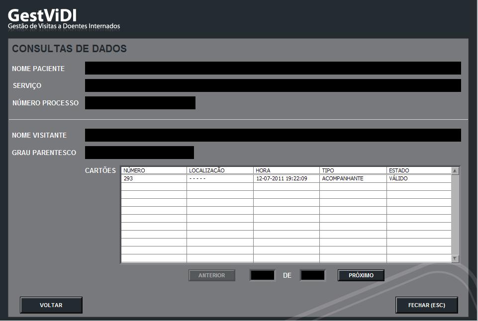

Hello a have an application that was running smoothly and now all the indicators are black. Does anybody have a sugestion?

Find>Property nodes.
One of them will be a buggy version of:
Somehow Text.BGColor is being set incorrectly (hmmmmm Black is the default colorbox constant value) You could also search for colorboxes!

Try to find out which color was selected in the first place. Aside from directly  defined RGB values you also have system colors (for Window ...) If someone changed your color scheme these may change as well. I had a problem while deploying an exe to a PC with different colors resulting in grey on grey indicators.

Your statement seems to imply that this happened all at once.  You might also check to see if the system settings on the machine you are using is the same.  Sometimes the use of theme matching colors can cause color changes.

Yes in fact it happened all at once.
I'm going to check the system settings and the windows fonts.

I have no property nodes linked to those strings indicators. 😞

I guess u might be on to something here:)
System settings, or color scheme or even system fonts...
