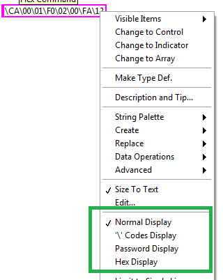

Just to visualize what Ravens refer to:
You have to either switch to Hex or '\' Code Display. If you chose the first option, the '\' must stay out as i recommended initially.

OK. I checked and I was in normal mode not in \ mode for my string.

Your LabVIEW code of sending "\CA\00\01\F0\02\00\FA\12" is definitely wrong because that was in normal display.  According to appendix D, you are supposed to be sending binary data, but you are sending a literal back slash "C"  and "A" rather than a hex byte of value CA.

3.  Set your constant to Hex display and type in the characters you want to send.  (you will not be typing any backslashes, I'm not even sure why you thought there should be backslashes.)

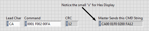

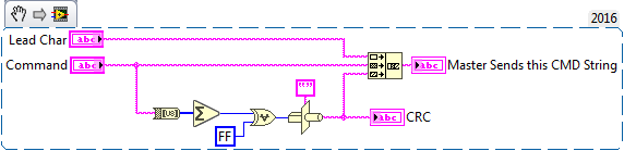

I'll try to help out. I don't have a NESLAB Chiller so I cannot vouch that these snippets will work. You will have to iron out the details.
From what I seen in the manual, the chiller does not use a termination character. You do not need to add one. The length of the message is embedded in the command. This is how I would build up the command syntax that the master would send.

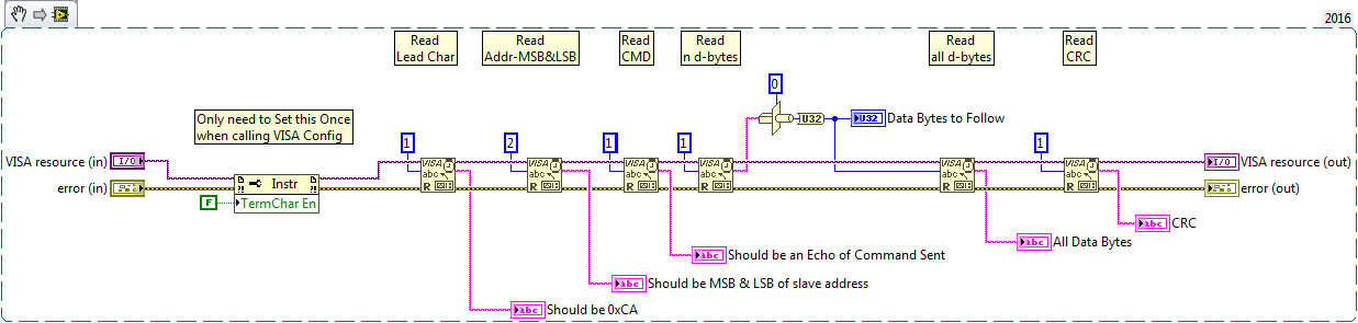

Reading the response from the slave is a little bit trickier since it does not send a termination character (make sure you DISABLE the TermChar when calling the VISA Config VI), but it has a well defined format for the response. First read in the preamble (first four bytes). Then read one byte to calculate the number of bytes to follow. Convert that hex string to an unsigned intereger and use that value to read in all the remaining data. Lastly you have an extra 1 byte to read to get the CRC checksum.
