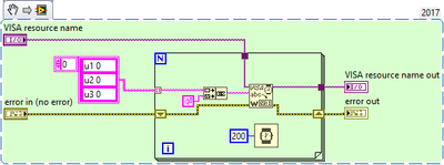

Dont' forget that LabVIEW features arrays. Instead of dropping 24 times a Write, you could simply create an array of commands and send them in a very compact code, see below an example for the first three commands. This would make much easier to introduce a delay between them if needed.

so after a short pause I experimented with larger delays in init VI and it solved the problem. I changed the old initialization VI with a new one where I set 100 ms after every write and now its working without problems. PC got a lot faster but the power supply did not and that caused problems. Thats why when I tried VISA Interactive Control and sent just one command I got a reply without problems but when I launched initialization of every channel with multiple parameters it went all south.
