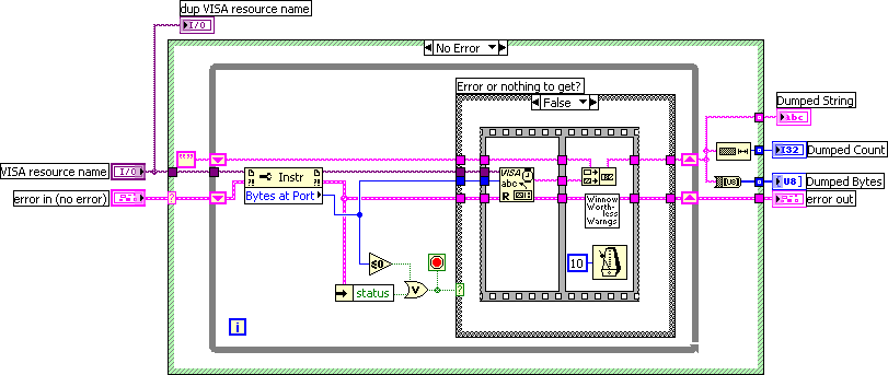

I'm guessing you are trying to use RS232 communications?  That is a bit different than the Galil DLL-based Ethernet communications that I use but it can be made to work. I believe that most Galil responses are terminated with a CRLF pair so you would want to configure the serial communications to terminate reads on a LF character.  Looking at the Galil documentation, the ":" and "?" character responses may not be followed by a CRLF but you can still use the VISA Serial Settings property "Bytes at Port" to watch (poll with timeout) for when the byte arrives and then you do a VISA read terminated on byte count (equal to the number of bytes in the buffer) to grab what's there. I've attached an image of a dump-buffer routine that I had handy and it is similar to what you would need for a read-response routine. But rather than stopping if no bytes are found, you would need to wait until a timeout time occurred or an expected response ( ":" or "?" or LF ) was received.
