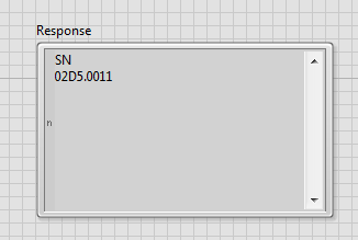

Thank you for the response. I will check out the linked video. The instrument I am using can have a varying number of lines returned marked by a carriage return. For example, I have been using the get serial number command to test as I know what should be returned. When I send that command ([SN]) it should return SN with a line feed and carriage return then it sends the actual serial number ending with a linefeed and carriage return. However, as my code is running it will only echo the SN command and then I have to click the write button again with no command to get the second line of the response. I have attached a screenshot of the response window with the whole response of the device, but I had to click the write button twice when I am trying to only click it once.

So try what I said about putting the VISA Read in a Loop until either the VISA Read times out or a check of Bytes at Port is equal to 0 after a VISA Read has been done.
