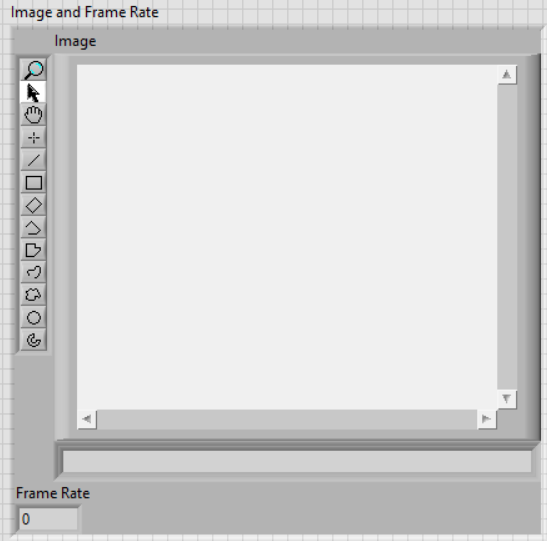

I think I don't understand the problem.  I put a Vision Image (Modern) on my desktop, opened a Cluster, dragged the Image into it, added a Dbl Indicator called Frame Rate, and had no problems.  I'll attach my cluster (2018), which looks like this:
Bob Schor
Message 4 of 11
(5,442 Views)

Hi Bob,
That is pretty much like my PRCS.ctl 🙂
The probleem is writing to the vision image in the cluster. In my ShowImage state of VT; PRCS; IO.vi I am trying to write the analyzed image (analyzed image due to boolean set to false) to the PRCS.ctl by means of a property node. Whereas the frame works fine in this way, the image does not.

Thanks for the "klop" to my head!  Of course, I knew (but forgot) that!  IMAQ is so "different" from other LabVIEW offerings, and so "under-documented", that we can fool ourselves!
I'm attaching "The Solution".  What I'd forgotten (since I did much of my playing with IMAQdx several years ago) was that the Front Panel "Image" indicators are not really the same kind of "indicators" we are used to thinking move on wires.  It is better to think of them as "complex routines that take an IMAQ Image, traveling on a wire, and render it so we can view and manipulate it".
There is another "Image" that truly is something that travels on wires -- it is what happens when we use IMAQ Create Image -- it makes something that travels on a wire.  That you can put in a Cluster.  I've done just this, creating a sub-VI called UTIL Get Image that puts a stock Image (I used "Desert.jpg") into an Image TypeDef with a Frame Rate of 1 (a silly, but recognizable, number).  This gets called by TEST Image TypeDef that unbundles the Cluster and wires the "Image" part to the "visualing" Image "Thing" we use to see the Image.  Sure enough, a picture of the Desert appears.

The simple answer is "You can't do that!".  There is definitely a virtue in creating a Cluster TypeDef that can "freeze" a nice arrangement of Controls (or Indicators) that one wants to fit on a Top-Level VI Front Panel, but that does not work for the Vision Front Panel Image "Indicators", as these are not "Indicators" in the usual LabVIEW "Give me Data in a Wire and I'll do something with it", but rather more complex entities that want a reference to an "IMAQ Image", a reference to a memory construct created by IMAQ Create Image.
What is an "Image"?  At one level, it is an Array of Pixels representing Grey or RGB values, along with supporting information such as the size of the Image and the internal representation.  When you use a Camera to take Images, they are stored in the IMAQdx Driver in "buffers".  To get to them, you create a Storage Location in your program that you call an "Image" with IMAQ Create Image and use Snap or Grab to get a reference to this Image (in some cases, copies of the Image Representation may occur, but in others, I suspect all that's being passed around is the Pointer).  This is the "Image" (a reference to where the Pixels are stored) that the "Display" (I'm not calling it an Image, but a "Display" which renders the Image visible to you) shows you.
So how do you get to have a nice Front Panel design for your Top-Level VI that incorporates a fixed organization between a Vision Display and other Controls and Indicators?  And why am I (incorrectly, I might add) emphasizing "Top-Level VI"?  A Vision Display only makes sense if you can view the Front Panel.  This is, of course, true for Top-Level VIs.  It can also be true if you display the VI's Front Panel in a sub-Panel (a technique I frequently use when I have multiple cameras whose output I want to view, one at a time).  Here's how to do this:
  • Lay out your Front Panel.  Include the Vision Display, with the Tools and View Options you want.  Put other controls and/or indicators that you want to group with it and align and space them properly.  You might also consider enclosing this "View" in a Decoration, such as a Raised Frame.
  • Select the items you want to "lock" into a Group.  On the group of icons on the Tool Bar in the group of 4 to the right, the last "ReOrder".  Select it and choose "Group".  You have now "locked" your chosen Front Panel objects so that they move as a group.  If you need to adjust the grouping, you can select, "UnGroup", re-arrange, and re-"Group".
I hope this answer both your question ("It can't be done") and solves what I think you might have been attempting ("Do it another way").
Bob Schor
