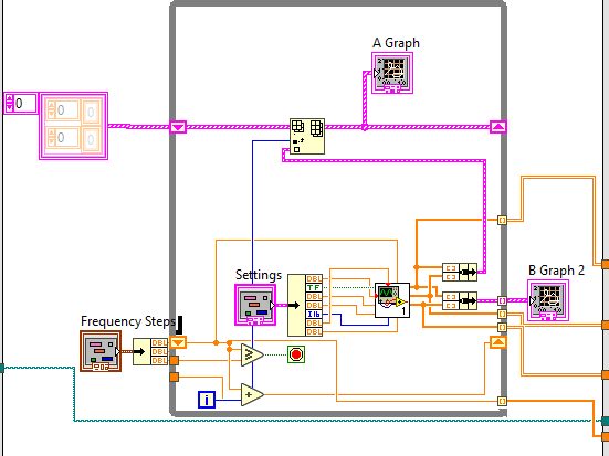

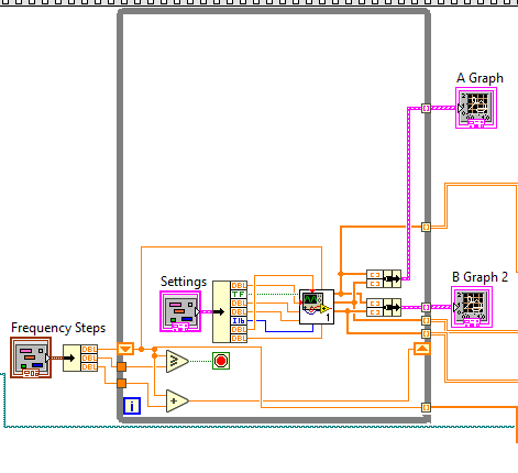

I came up with this solution and I will try this now-
