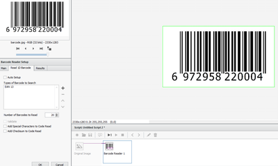

Vision is not able to parse the 1D barcode
Hi Sir,
It is strange, vision assitant is not able to parse the barcode, but i use iphone, it is fine, and the pattern is ENA-13:
Any setting is not correct ?
Thanks.

Sorry, updated the pic:

After i zoom out the pic, looks fine to read the value:

For me it works like a charm, just make sure your image is in grayscale, that's why I have added a color plane extraction.
Check out the script attached.
