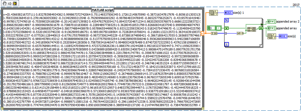

Yes I tried that way as well. Attached is the VI. I am getting an array of 15001 x 16 while I wanted an array having just one row and 15000x16=240000 elements in that. Please tell me where am I wrong.

Hi maverikk,
did you read the help for BuildArray? Did you notice the concatenation mode it supports?
Two different options shown in the image.
(I'm not sure your LabVIEW2014 already supports concatenating output tunnels…)

Yes it supports concatenation. Thanks to you I got the data in 1D array having 240000 elements. Now I want to transmit it via a DO channel so I converted it into a digital waveform. Its transmitting without any error and on a single DO channel but at the receiver side no output is visible.
