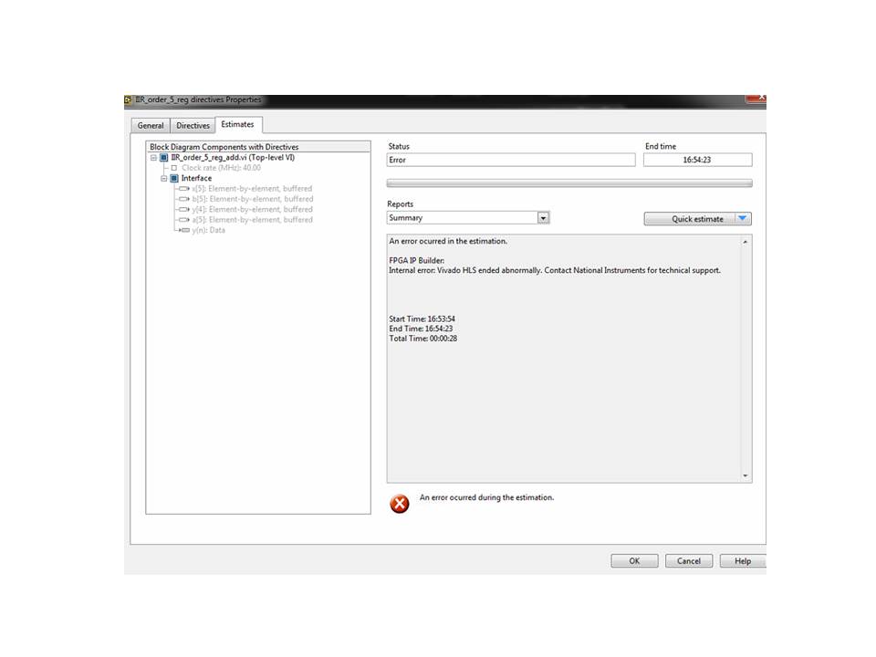

I just installed LV 2014  32 bit and the FPGA module for LV 2014. I also installed 2014Xilinx14_7.
I can create directives from a VI. However, when I run "quick estimate" on the selected directive, suffered from an error of
"FPGA IP Builder: Internal error: Vivado HLS ended abnormally. "
The same propgram works well unver LV 2012.
Any suggestions?

Hi, James

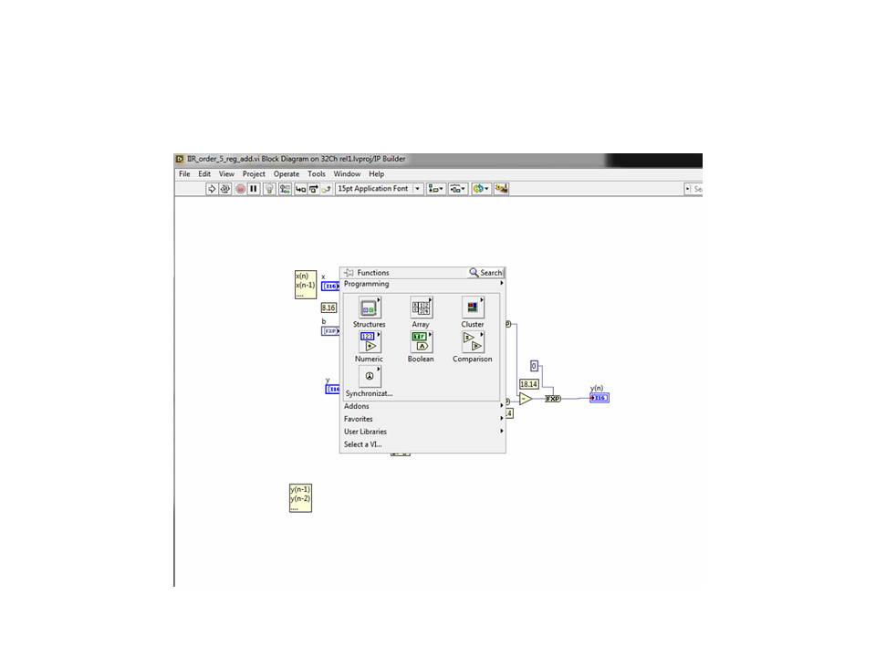

The device is PCIe-7842R. Please see the screen copy.
As I see in the below link, LV2014 should support vector and matrix operation, such as dot product. However, I don't see them in my system.
thanks
