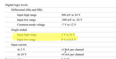

As per the 9411 datasheet, anything above 2V is considered a high in single ended mode - this is how your +/-2.5V works
