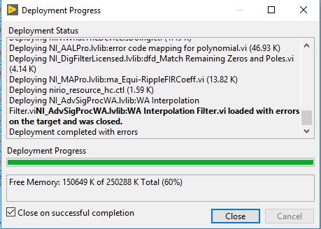

WA Interpolation Filter.vi Error on ECG myRIO
This problem pops up when we are trying to run the program. We tried reinstalling advance signal processing toolkit but it still doesnt work

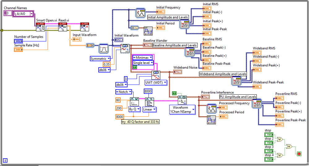

Error when we tried to runError when we tried to runHere's our block diagramHere's our block diagram

We are using Advance Signal Processing 2017 together with Labview 2017. When we removed the WA detrend.vi, it will run. We already tried reinstalling the ASP2017 and Labview but the error still occur

I found these two links that you may find helpful.
Real-Time Deployment Error: VI Loaded with Errors on the Target and Was Closed
https://knowledge.ni.com/KnowledgeArticleDetails?id=kA00Z000000P8ejSAC
Labview RT/FPGA Compling Error with NI_DigFilterLicensed.lvlib
https://forums.ni.com/t5/LabVIEW/Labview-RT-FPGA-Compling-Error-with-NI-DigFilterLicensed-lvlib/td-p...
