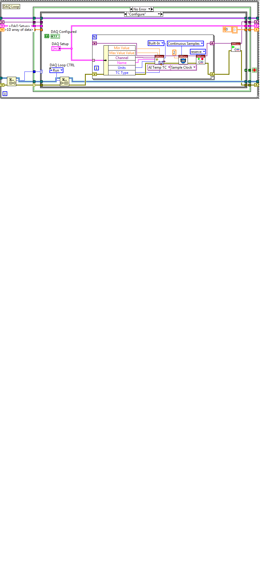

I'm trying to configure a DAQmx task with a 9219 in a WLS9163.
The task has 4ch of "AI Temp TC".
If I run my program with the 9219 in a 9171 USB carrier everything works OK.
If I run the program with the 9219 in the WLS9163 carrier I get the following error when reserving channels in the task:
Error -201105 occurred at TemperatureMonitoring_v1.0.vi
Possible reason(s):
Resource requested by this task has already been reserved by a different task with conflicting settings.
Unreserve any other tasks using this device, or change their settings to be compatible with this task.
Task Name: _unnamedTask<A>
I'm not sure how the task config is different between the USB-9171 vs WLS-9163 carriers.
Here is the relevant block of code:

Is this behavior present if you skip the DAQmx Control Task.vi in your configuration? This problem has appeared in the past when a task has been explicitly reserved or committed and the task is reconfigured. So if possible, let’s try removing that VI from the configuration and tell us if that solves the issue. Have a nice day.

That works.
If I don't reserve the task it works just fine with both the WLS 9163 and the USB carrier.
