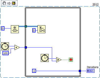

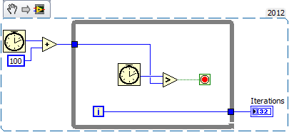

First standard, how many iterations do I get without any sync structures. Result = 3 750 000 iterations

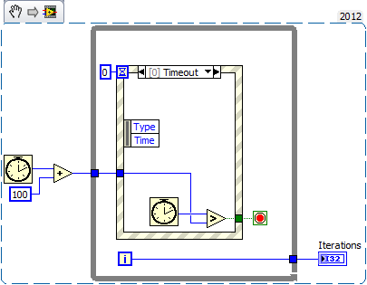

Second, to see the wait structure overhead. Result = 630 000    This was quite shock, I thought it would be around 1/3 of the waitless loop.
Third, a bit shocky. Result = 34 000 So the wait structure overhead is not so huge...

In none of your examples are you calling the Wait function, you are simply checking the current system counter value. The wait function looks like this:
I'm not sure simply checking the system clock count will actually cause any thread swapping to allow other processes some CPU time.

I made those examples just see the how much overhead the checking of incoming events/elements costs in terms of performance.
