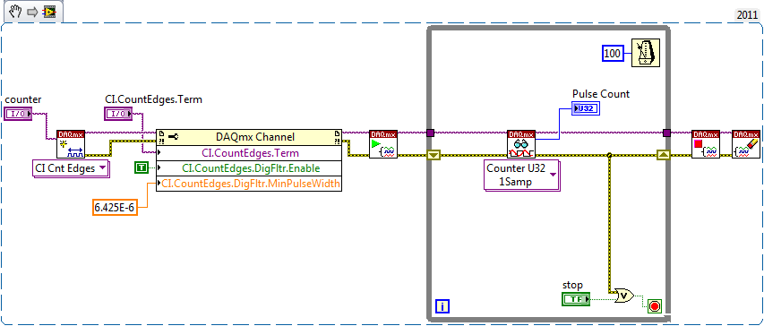

@Indiano wrote:
I am using USB 6210 I/O and want to count the pulses in my digital signal generated by gear tooth sensor...
You should really just use one of the hardware counters for this.

Fair enough, but doing it this way will ultimately limit how fast of a signal you can measure (might not be an issue for you).
