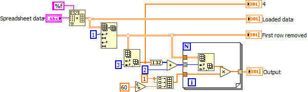

kindly find the attachment.
(1,864 Views)
  • Please fill the string control with typical data, make it the default, and attach the VI once more.
  • Also save with a reasonable default value of "milliseconds to wait".
  • Never have terminals without labels
  • "delete from array" is not the correct function to take an "array subset"
  • The index array needs to be I32, not DBL
  • What is the point of the FOR loop?
  • Please explain what you mean by "extract"

I have tried to explain in block diagram. Hope you can understand what i want to make.i'm sorry as I am new to the software.
(1,851 Views)
Its a bit confusing because you number the rows 1 based, while array indices are 0 based. (It is also not clear why you need to remove the first row, because you can account for the position shift later if needed.)
Here's a quick draft that maybe can give you some ideas....
(1,827 Views)
