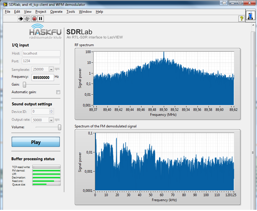

I have been playing with a Reltek DVB dongle lately, these things can be turned into simple SDR's using various software.

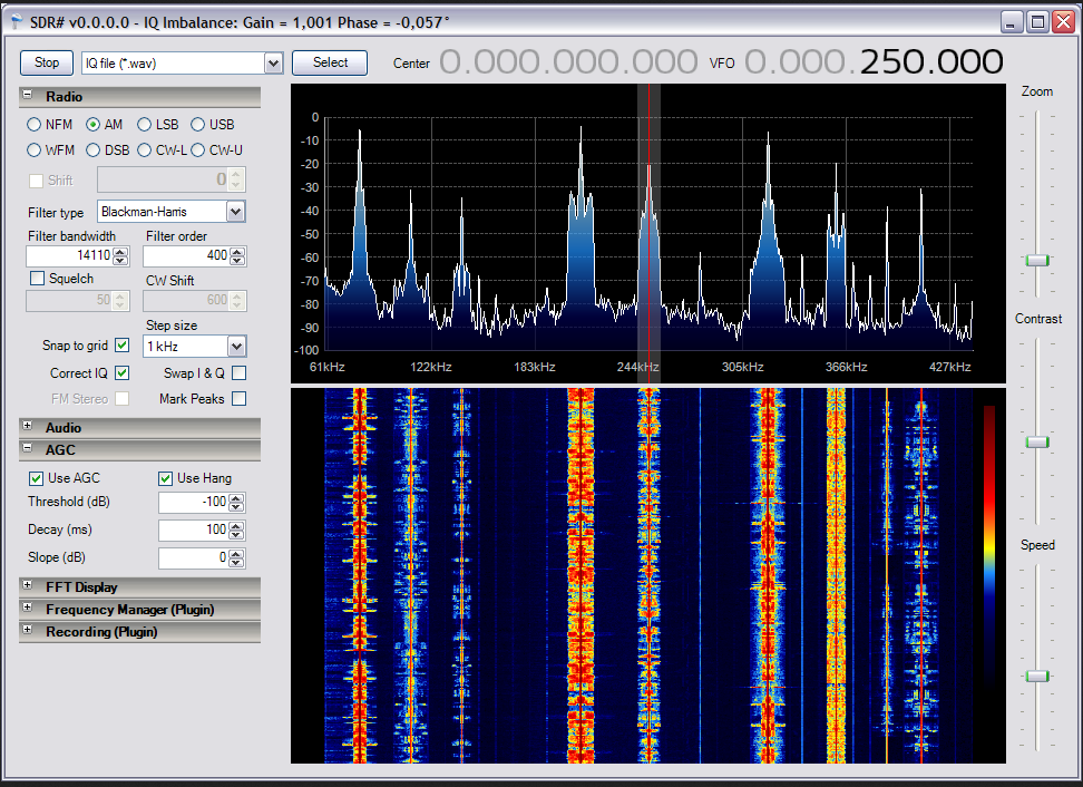

I ram across some LabView code for it and would like to add a waterfall display like SDR# has.
Am I wrong in thinking a waterfall is an intensity graph that is rotated to scroll from top to bottom instead of right to left?
I have never used an intensity graph but was looking at the example this morning. I see no way to rotate the graph to scroll it from top to bottom.
Ideas and advice would be appreciated.

Are you confusing the intensity chart with intensity graph?
We use intensity graphs all the time to scroll data in both directions. We use the minimum and maximum property nodes to make the graph appear to work similar to a chart. It might just be something like that?
