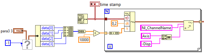

As you can see in the below screenshot which is a section of waveform chart mentioned in the code has a lag after running for 4 hours. Here the flat line denotes data from CNC controller and waves denote data from DAQ. I also placed a Get Queue Status function to get the number of elements in the queue for both the queues and found out DAQ loop is slower showing 32 elements in the queue after 4 hours while the CNC controller data queue remains 0 and rarely goes to 1 at times.

If the DAQ queue has more elements in it that means it is producing data faster than the other loop. You can check the waveform dt to get the actual sampling rate.
If you want to keep the current setup, you need to occasionally request more than one sample from DAQmx Read, the Waveform Chart can handle varying lengths. If the queue is not empty, read two samples, if it is empty, read one. Seems a little suspicious to be honest, but it might work for you.
Otherwise, you need to enqueue data into a single queue and roll your own Waveform Chart buffer that identifies channels by their name. Then use a waveform chart to plot your data. You will not have the same funcitonality as with a waveform chart, but it might be enough for you.
