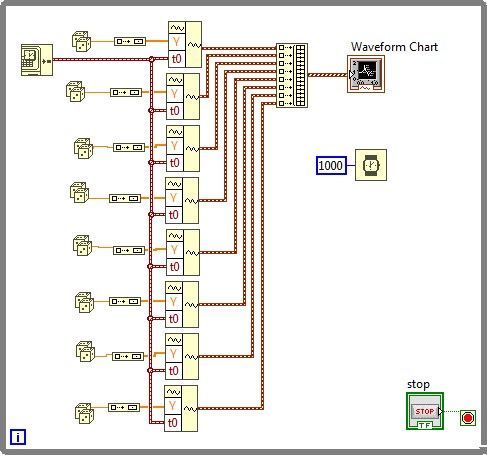

Hello,  Could someone help making waveform chart  vi more efficient.  I'm collecting 8 channels of data.  In order to use the waveform chart I have to rebuild each wave form with the get date/date.  All eight points are collected simultaneously but using the attached vi Its making a timestamp for each of the 8 data points if you export to excel.  Seems like a waste collecting a timestamp for each piece of data but it's the only way I could get it to work.  Anyway is there an easier way to make this more efficient or clean it up.  I only need to collect points every 2 seconds or so. Thanks in advance.

Hi jon,
what about using (autoindexing) loops?

Either you don't quite understand Waveforms and Sampling or I don't quite understand what you are doing!  Here are some comments:
  • A "Waveform Chart" doesn't necessarily have anything to do with Waveforms -- it is just a way of plotting things (like Waveforms) that consist of equally-spaced (timed) variables, so the X axis is effectively equally-spaced Sampling Time, and hence not explicitly specified.
  • Inputs to a Waveform Chart can be a Waveform (or an Array of Waveforms, to get multiple channels).  A Chart has "memory" -- points are "added" to the existing Plot so you can see it evolving over time (there are several modes for updating, so it can emulate a Strip Chart, scrolling data to the right and the "background" to the left, or a Scope, where the data "overwrites" as it goes from left to right.
  • You can plot one point at a time (a scalar input), an array of points (updating multiple points at a time), or a Waveform (which carries "starting time" and "dt" along with it.
  • If you are collecting data every 2 seconds (not "every two seconds or so", Charts expect to be updated at equal intervals, as the X axis strictly increments), then forget about the Waveform, just plot a point every two seconds.  To get the X axis to reflect Time properly, you can manipulate the Multiplier property of the Axis.
  • If you want to plot multiple channels, you don't make an Array (which means "multiple Time points"), you combine them into a multi-element Cluster.  Note that there is an Array to Cluster function that can help you here.
Bob Schor

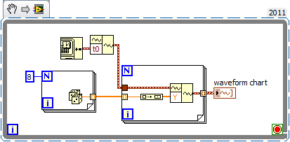

Thanks Gerd,
Your example absolutely cleans things up and will help much.  However, when I export the chart to excel I still get a time and date stamp for each of the 8 columns of data.

I have a 16 channel system that already writes to a text file and has a date column and time column along with 16 data columns without a strip chart.  I figured I put a strip chart in the vi to improve it and noticed the export to excel.  I made up a quick vi by GerdW recommnedation and it does export to excel when I right click.  Both vi and excel data sheet attached.  Gerdw's recommendation will clean up the larger vi but still produces a date/time stamp for each data point.
