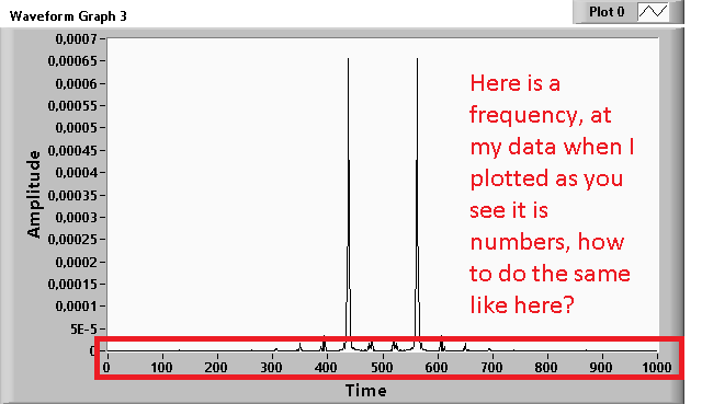

Lynn, thank you. It looks much clearly for me, but you added FFT.vi, as you said to get freq range (-inf;+inf), but I dont get a two things: how to get on the x-axis the frequency, NOT a numbers likes 100, 10000 and so on, I need to have a frequency, how to do that? I think it supposed to be done something if dT or sampling. You calculated FFT form Magnitude and have got a spectra, it is the same to do for phase? Please look at my example, I need that it looks like the same situation (y-axis mag, x-axis frequency) on the example.

To change the axis labels just select the labels with the text tool and type what you want.
To change the marker values on the X-axis you can use the X Scale: Multiplier and X Scale: Offset properties.

Lynn, I want to get a freq domain and plot it with amplitude domain and phase domain. It is possible? That is why I am trying to do and get a graph. Can you help with code and re-fixed it? I dont know how to get plot the freq on the x-asis, you have seen too, that according data on the x-asis it is just numbers or it is sample numbers, I need a freq. Thank you

How to see frequency on X-axis? Not numbers i.e 10.000 as are at my code
Message 35 of 45
(2,778 Views)
Exactly, how to extract frequency from FFT spectrum?
Message 36 of 45
(2,758 Views)
A waveform consists of 3 main parts,  T0  (time of the 0th element), dT,  time between elements, and an array of Y which is the magnitude of each sample of the waveform.
When you pass that through the FFT, you get a cluster that is very similar in construction to the waveform.  You get an F0  (frequency of the zeroth element which is almost always 0.   a dF, the difference in frequencies of each element of the array.  And the array which is consistes of the magnitude of each frequency.
So if you have a value of 100 in the 10th elemente of the array.  That means you have an amplitude of 100 at a frequency of 10 * dF.  If dF is 1 Hz, then the magnitude is 100 at 10 Hz.
Feeding that cluster into a waveform graph, because of its similar construction, allows you to see an FFT graph.
