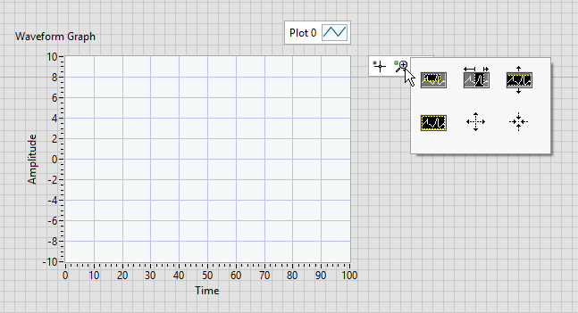

  • Enable the Graph Palette to have tools to zoom and pan the graph live.
    Also: Graph Palette Is Too Small or Display Graph Palette

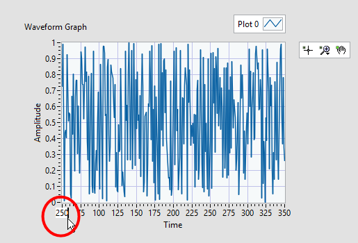

  • Double-click the axis' min or max value while the program is running and type a new value you want to have. Press Enter at the end.
