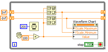

You are not saying anything about the "minimum". Should it be zero or adjusted to the smallest value found so far? Once you turn off autoscaling, you can set the range at any time using a property node, which only need to be done when the max or min changes, not with every update, of course (not shown).
In the simplest case, a chart gets one scalar point per update, so here's a solution for that:

The difference between the two examples is that I use a chart instead of a graph, which is useful if data arrives continuously and prevents memory issues because charts have a fixed history length.
Storing an ever-growing array in memory can lead to performance problem and doing array min&max on an ever-growing array gets harder with time. In is entirely sufficient to to keep track of the scalar min and max as I do.
(There are some other odd points in the example by "di". For example why is the shift register initialized with an array containing a zero instead of with an empty array? A zero might not be a reasonable value at all, for example if all values are negative, the max will be fixed at zero from the beginning. Also "insert into array" is not the right tool to append to an array, "build array" is. Insert into array is a significantly more complicated function, only needed when inserting somewhere in the middle of an existing array, moving all higher elements up in memory. Well, the compiler will sort it all out, but the diagram is still less readable because it is less obvious what actually happens if the index is not connected)
As mentioned, you should only rewrite the properties if the max/min has actually just changed (which will get rarer and rarer in your scenario). Properties are relatively expensive.
