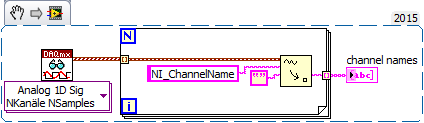

I figured it out, just have to do it as a two step process, like this.
Thanks.
Message 6 of 10
(5,538 Views)
Hi dude,
using my comment it would be a one step process…
Message 7 of 10
(5,526 Views)
can you provide an example?
Message 8 of 10
(5,522 Views)
Hi dude,
one step:
Message 9 of 10
(5,499 Views)
Could have sworn I tried that and was getting error?!?!?! Anywho, thanks for the suggestion.
