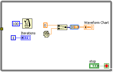

I have this problem with the waveform chart in LabVIEW 2009, The Graph will not be displayes on the chart after a few iterations. This is a bug that appeared in LabVIEW 2009. The same program worked fine with LV 8.6. Does anyone know a workaround for this problem? I am currently using Version 9.0f2
See attached block diagram

I verified that saving this back to 8.6 does indeed work.
If you replace the Merge signals function with a Bundle function things seem to function properly.

In running the OP's code, I did see an error 1055 happen for an unreferenced object.  That was due to the fact that with VI snippets, things like property nodes that are implicitly linked to an object get recreated in a way where a reference control is created and feeds into the property node.  That raised an invalid object reference because the Waveform chart reference control is no longer actually connected to the waveform chart.  The empty reference causes an error.  So you need to delete reference control, then relink the property node to the waveform chart.
Once I did that, (and fixed the property nodes so they were all in one block instead of 4 space hogging blocks), I was able to the run the VI.  I did notice odd things happening with the chart.
1. Almost immediately, there were redraw issues with plot 0.  It would show 1 data point, then nothing after that.  If I stopped and restarted the VI, the missing data points for plot 0 from the previous run would suddenly appear, but then not show any for the current run of the VI.
2.  After about 100 iterations, plot 1 stopped moving across the control like it should and just seemed to only show the last two data points at the right hand side of the chart.
Overall, there seem to be bugs.  There seem to have been several bugs related to the waveform chart in LV 2009.  Whether this is one of them, related to one of them, or a new, completely undiscovered bug, I don't know.  Here is a cleaned up version saved as an actual VI (instead of a snippet), for others to try and confirm in LV 2009.

2009 0f2
I get the same (incorrect) functionality with Ravens Fan's Chartbug.vi
To reiterate, a workaround is to use a Bundle function (from the Cluster palette) rather than the Merge Signals function.
I put a probe on the Dynamic Data wire to try and see if the data going into the chart was correct, but there does not seem to be any useful info in the probe display. There is a data tab where nothing changes and a Graph tab that just jumps around without plotting anything. So its hard to say whether the Merge Signals function is generating bad data or the chart is not plotting correctly.

Hi
I get the same behavior after recreating the VI from scratch. Another workaround is to convert from Dynamic Data to an array before the Waveform Chart.
Did a quick search in the CAR database and I found some cases that are similar to this. I think I'll add this to one of them. Thanks for bringing it to our attention.

Thank you all for the suggestions, both Steve's and David's solutions worked, I did liked Steve's solution better.
