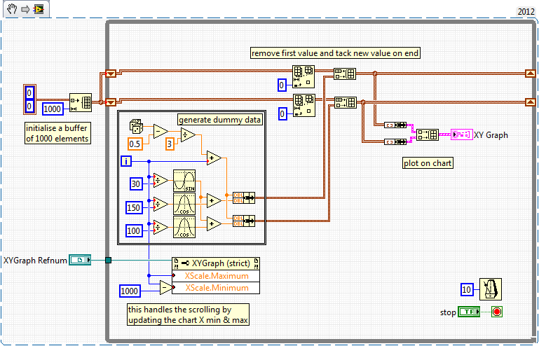

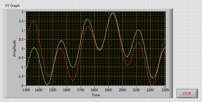

If your data is evenly spaced along the X axis then there is no reason not to use a chart and just set the X axis to whatever units and scale you are using. But if you have variable X data and so need an XY plot then you can mimic the chart behaviour on an XY graph by creating and maintaining your own history buffer.
The attached vi uses a shift register to maintain a buffer and deletes the first item and adds one new data point to the end each iteration. The X axis max and min are updated each time to give the 'scrolling' effect, but once you have this setup you can do all kinds of useful things like pause chart updates (even tho data is still going into the buffer) so the user can scroll around in the live data, and so on. To get a 'sweep' update instead of scrolling, then overwrite array values instead of tacking the new data to the end. Very flexible.
This vi also shows an example of plotting multiple plots on an XY graph, but check the help text because there are several formats accepted and a different one might suit your data/application better.

Stuart, your approach looks great but the plots do not appear on my vi... and just to be sure, how would you overwrite array values? Is it by replacing the Initialize with the Replace Subset?
