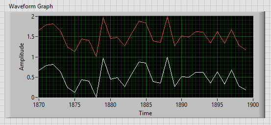

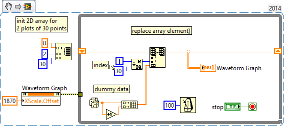

Thats because, as far as the chart is concerned, you are just adding more and more points to the end of the trace. If you do your last measurement at 1900 and go back and take another one at 1870, the chart has no concept of that - it just adds the new data point to the end of the buffer (because as a chart it takes only Y values and assumes the X value is just the next data point in the sequence).
If you want to keep updating the sweep over and over with the same x values then you will need to handle things differently. Similar to the XY chart example, I would keep an array of the 30 data points and update the array, then feed the entire array to a waveform graph. You don't get the fancy sweeping vertical line that you get with a chart in sweep mode, but otherwise its close enough.
This little noddy shows the idea using a waveform graph and two plots.
Message 29 of 46
(1,944 Views)
the issue with the x axis continues, and now the VI creates 30 plots instead of 2... as you can see both plots are set to display IM Power.. but instead of getting 2 , I am getting 30... which makes no sense cause' I believe it is wired just like your VI ... and the X axis continues to increment.. is it because the chart needs to be inside its own cycle?
