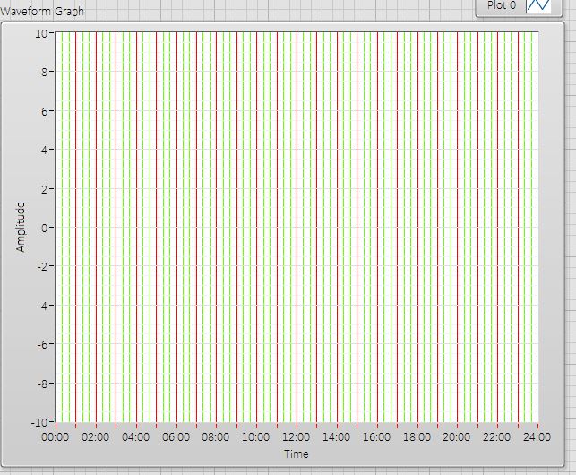

this is my vi can someone help in plotting the graphin 20 minuts gap and the format should be 8:00 8:20 for 24 hours

There is a Marker Spacing property to which you can write a custom array. This sets the scale Marker spacing to arbitrary.  See attached vi as an example.  Work still needed to make it look acceptable regarding labels.
You could make the marker every 1 hour, the minor tick (not labled) cannot be controlled,  A long chart will have 10 minute minor tick
- half the size of the chart and it will be 20 minute
If you want continuous output I think you need to use a Waveforn Chart rather than a Waveform Graph with chart history length set to 86400 (number of seconds in 24 hours

Is there any way to start the graph from 8:20 morning and end it to next day morning 8 O clock with major ticks of 20 minutes each

Slightly modified version as saved as LabVIEW 11.
Basically it is a waveform chart with 72 points on it (The number of 20 minute periods in 24 hours)
To make them appear 20 minutes apart on the wavefront chart you set the multiplier to 20 x 60 = 1200
To start at 8:20 you set the multiplier to 8 x 60 x 60 + 20 x 60 =30000.
Good luck
Ken

Can you tell me how can I fix my chart to be from 00:00 to 23:59 in my X axis. Where do I change the length to 0-1440?

Hi Svaldez,
You can change the length of the chart by right clicking on it -> Chart History Length.
In terms of having the x-axis to start at 00:00, you can set the display format to be relative time.
