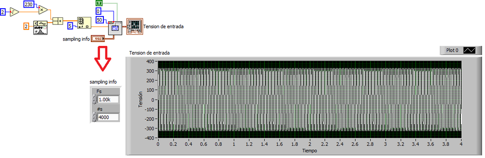

I am attaching a photo. You coud see different amplitude values of the signal. I woud l like to plot generated random numbers in that way, because they all represent different levels of amplitude of the signal.
Sorry, I cannot see that. You have a repeating cycle of several harmonics of some fundamental period (outlined in green), but each repeat has very similar amplitude.
